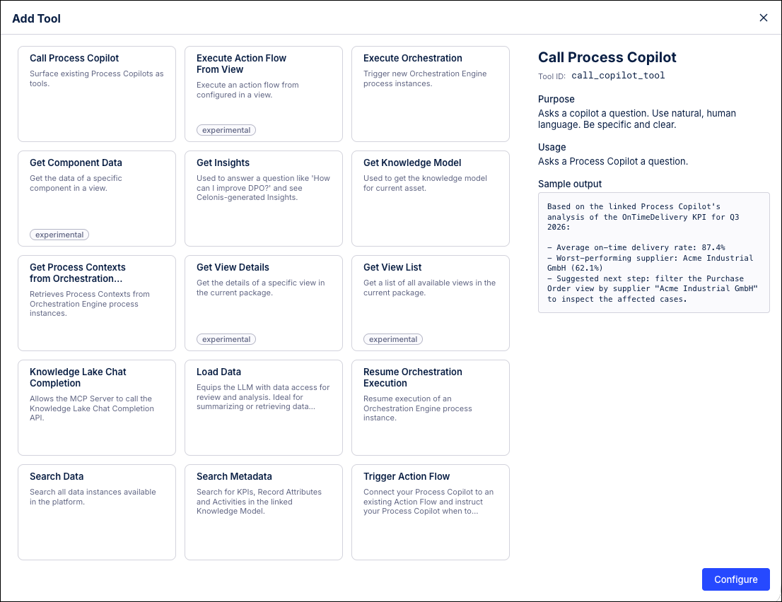

## Available tools
The following tools can be enabled for your Agent Tools/MCP Server assets:
| **Tool** | **Description** |
| [Call Process Copilot](/mcp-server-asset/tools/call_process_copilot) | Delegates a question to a specific Process Copilot. |
| [Execute Orchestration](/mcp-server-asset/tools/execute_oe) | Sends a signal to Orchestration Engine to start a digital process. |
| [Get Insights](/mcp-server-asset/tools/get_insights) | Finds improvement potential by analyzing a KPI against record attributes. |
| [Get Knowledge Model](/mcp-server-asset/tools/get_knowledge_model) | Returns the knowledge model for the current asset. |
| [Get Process Contexts from Orchestration Engine](/mcp-server-asset/tools/get_process_contexts_from_oe) | Lists or queries digital process instances from Orchestration Engine. |
| [Load Data](/mcp-server-asset/tools/load_data) | The primary tool for loading data from the knowledge model. |
| [Resume Orchestration Execution](/mcp-server-asset/tools/resume_oe) | Resumes a paused Orchestration Engine process instance. |
| [Search Data](/mcp-server-asset/tools/search_data) | Searches for record instances using keyword matching or semantic search. |
| [Trigger Action Flow](/mcp-server-asset/tools/trigger_action_flow) | Connects your asset to an Action Flow. |
