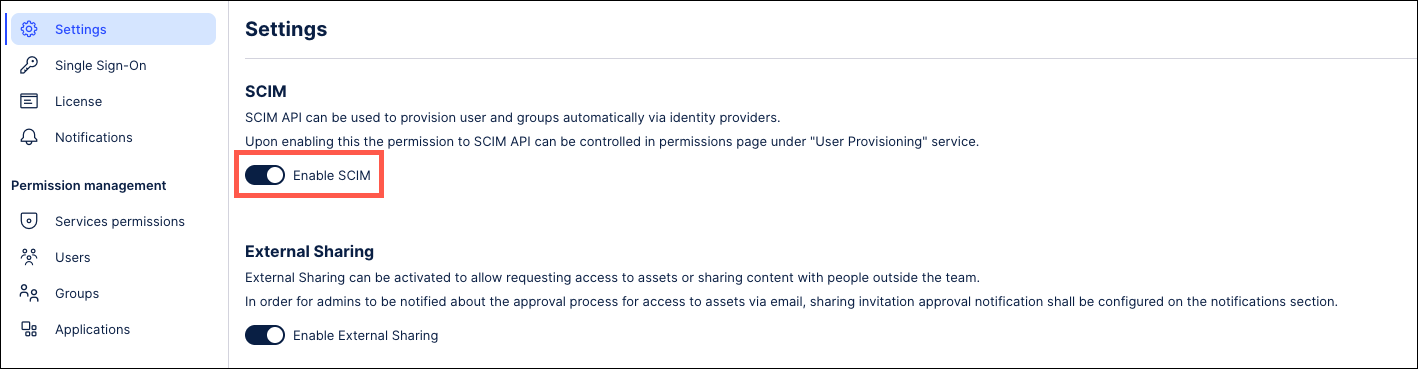

To enable SCIM for your Celonis Platform team:
  1. Go to Admin & Settings > Settings and then switch on the Enable SCIM toggle.
    Screenshot of the Settings module in the Celonis Platform with the Enable SCIM setting highlighted.
    SCIM can only be enabled if Just-in-time (JIT) user provisioning is disabled. See Configuring SAML JIT single sign-on.
