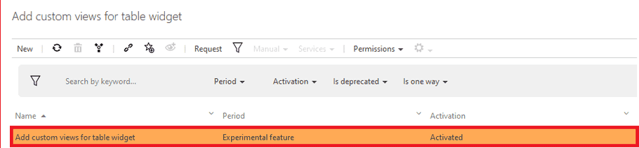

In this case, search for the feature with the name 'Add custom views for table widget' as you can see in the screenshot below.
Screenshot activation of feature flag

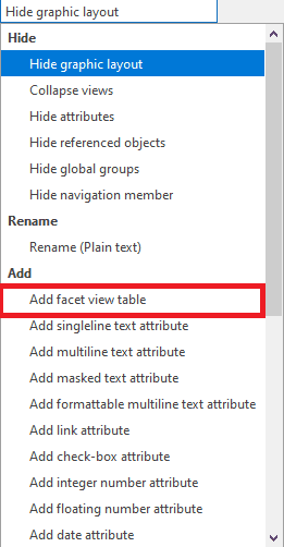

Create a new customization by selecting the 'Add facet view table' type in the type dropdown. You can now chose a custom name for your new facet view table customization like you can see in the screenshot below.
Screenshot creation of new customization

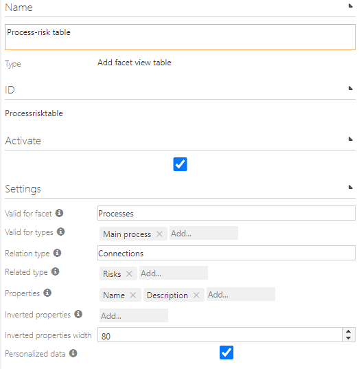

Configuration of the facet view table
Once you have created the new facet view table configuration, you are able to configure the facet view table in the detail content on the right while the configuration is selected.
Screenshot location of settings
The settings you can see are described in detail below. Please note that the values you select depend on the ones above. With that said, changing one of the above values, will have direct impact of the values you can select below.
Valid for facet / valid for types
The selection field 'Valid for facet' describes for which facets the new customization is available. Dependent on that, 'Valid for types' will change dynamically to the available types in the facet. Please note that you can select multiple values here.
Relation type / Related type
The selection field 'Relation type' lets you choose between 'Connections' und 'Content'.
Relation type: Connections
Connections are available on most of the given types you can select. It describes the relation of the element to the related type.

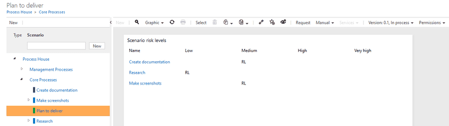

Screenshot entered data Screenshot result

The selectable value content describes the content of the selected element. For example, if you selected a scenario as type and the scenario contains main process interfaces, the main process will be listed as content of the scenario
Screenshot result
Related type
The selection 'Related Type' depends on the Relation Type you selected earlier. Here you can either see the elements which are connected to the valid types or the elements which are contained in the valid type.
Properties
Here you can select the properties of the the related type you would like to see in the table widget
Inverted properties
Similar to properties, you can see the properties of the related type you would like to see. With the difference, that values of the property are listed as columns.
Inverted Properties Width
Set a fixed width of each of the inverted properties columns and align them to the right side of the table widget. We suggest a starting value of 50 to 100 and adjust accordingly. If this value is set to 0, both properties and inverted properties columns will be spaced evenly.
Personalized Data
This setting allows you to utilize your scope filters.
Once you have configured all the values inside of your customization, please remember to activate the customization and to click on 'Apply changes' in the toolbar.

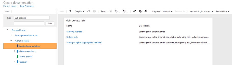

  1. Navigate to the facet you configured your table widget for (e.g. 'Processes' )
  2. Make sure you are located in the 'graphic' view
  3. Create a new element of the type you enabled the fact sheet for or select an already existing element
    1. Enter some of the properties you enabled the customization for if not already done(e.g. KPI, Risk level or similar)
  4. Select the created or existing element
    1. In the toolbar, select the 'Graphic' -button
    2. In the dialog which opens up, select the table widget which you created earlier
  5. You should now see the configured table widget with the configured values inside
