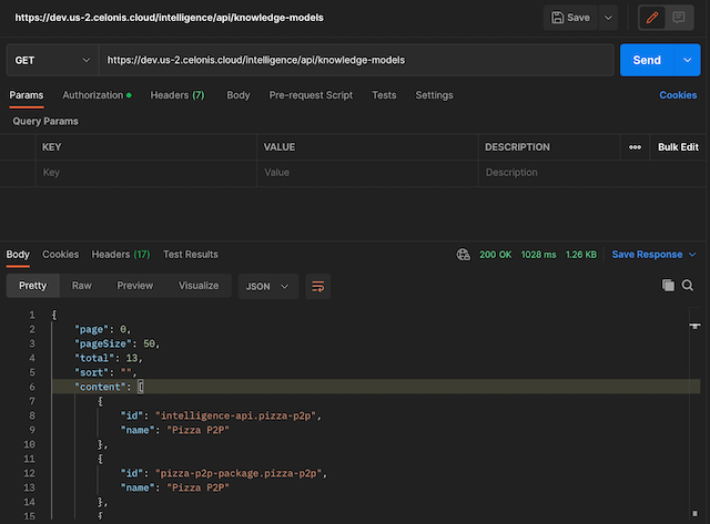

List of Knowledge Models
As you saw in the Getting Started page, you can get the full list of Knowledge Models that you have access to, creating a request to https://<team>.<cluster>.celonis.cloud/intelligence/api/knowledge-models (remember that you need to replace <team> and <cluster> with your own values).
Knowledge Models response

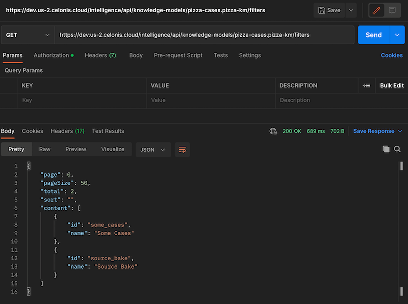

List of Knowledge Model Triggers
You can get the full list of triggers that a Knowledge Model has, creating a request to https://<team>.<cluster>.celonis.cloud/intelligence/api/knowledge-models/<km_id>/triggers. For this URL, you will need to replace the <km_id> with the Knowledge Model id that you got from the previous endpoint.
Knowledge Models filters
